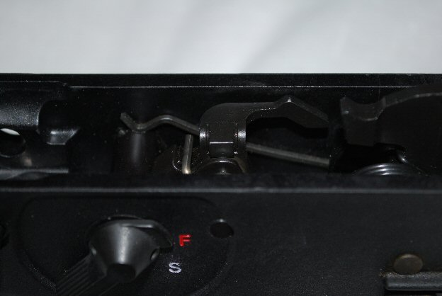

small metal part fell out while cleaning cant find where it goes!
So i was cleaning my 522 yesterday and after i had it all cleaned and back together i noticed a maybe 3-4 inch thin metal wire/strip with a hook shape on one end and a little kink on the other. i asked my friend where he thought it goes and he couldnt figure out either.
any ideas?
Judging by your description, Id say probably the safety detent spring (part 36)
Shown in the pic below....
If you cant find it, open your manual to page 53, and it shows a complete parts breakdown.
yup thats it, thanks a bunch!
