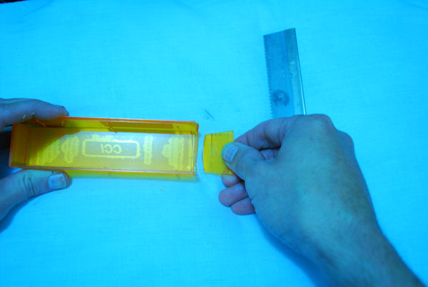

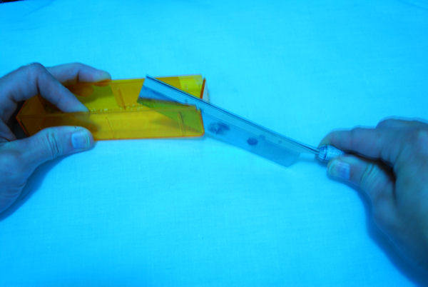

bdavison Posted October 29, 2010 Author Report Share Posted October 29, 2010 Step 2 - Use a razor saw, or dremel tool (with cut off wheel) to cut down one side of the box. Quote Link to comment Share on other sites More sharing options...
bdavison Posted October 29, 2010 Author Report Share Posted October 29, 2010 Step 3 - Cut down other side of box. Quote Link to comment Share on other sites More sharing options...
bdavison Posted October 29, 2010 Author Report Share Posted October 29, 2010 Step 4 - Snap or cut off the tab from the end of box as shown in pic. Quote Link to comment Share on other sites More sharing options...

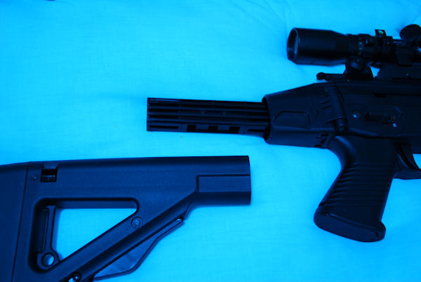

bdavison Posted October 29, 2010 Author Report Share Posted October 29, 2010 Step 5 - Remove Stock from rifle. Depress the adjustment button, and pull down on the stock retaining pin. Then slide it off the rifle. Quote Link to comment Share on other sites More sharing options...

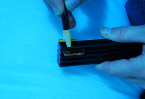

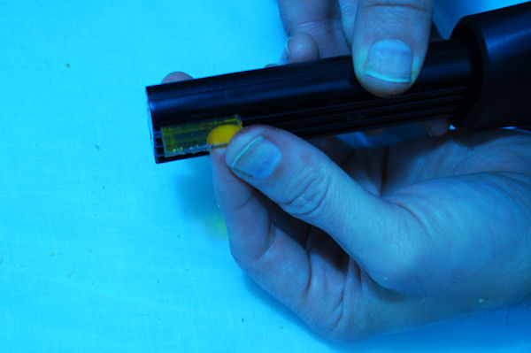

bdavison Posted October 29, 2010 Author Report Share Posted October 29, 2010 Step 6 - Insert your plastic piece into the end of the stock as shown. You kinda want a friction fit. Quote Link to comment Share on other sites More sharing options...

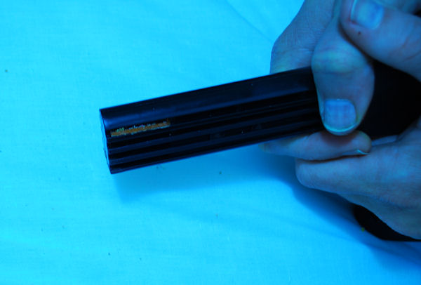

bdavison Posted October 29, 2010 Author Report Share Posted October 29, 2010 Step 7- Using a sharpie or grease pencil, mark off both sides of the stock. Quote Link to comment Share on other sites More sharing options...

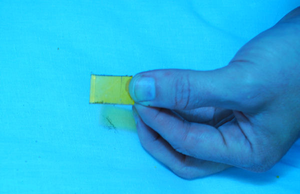

bdavison Posted October 29, 2010 Author Report Share Posted October 29, 2010 Step 8 - Use your razor saw/dremel to cut off the excess plastic. YOU WANT TO CUT IT BIGGER THAN THE MARKED LINES! You can shave it down or trim it off to fine adjust it. Quote Link to comment Share on other sites More sharing options...
bdavison Posted October 29, 2010 Author Report Share Posted October 29, 2010 Step 9 - Insert piece back into stock as shown. And slide stock back onto rifle. If the stock fits too tightly, you can trim a little more off the plastic piece. Trim in small increments. Its ok to leave the edges rough, actually it works better that way.Presto....wobbly stock fixed.If you are constantly adjusting the length of your stock, eventually the plastic piece might get worn down a bit...but it should work for quite some time.Enjoy!!! Quote Link to comment Share on other sites More sharing options...
