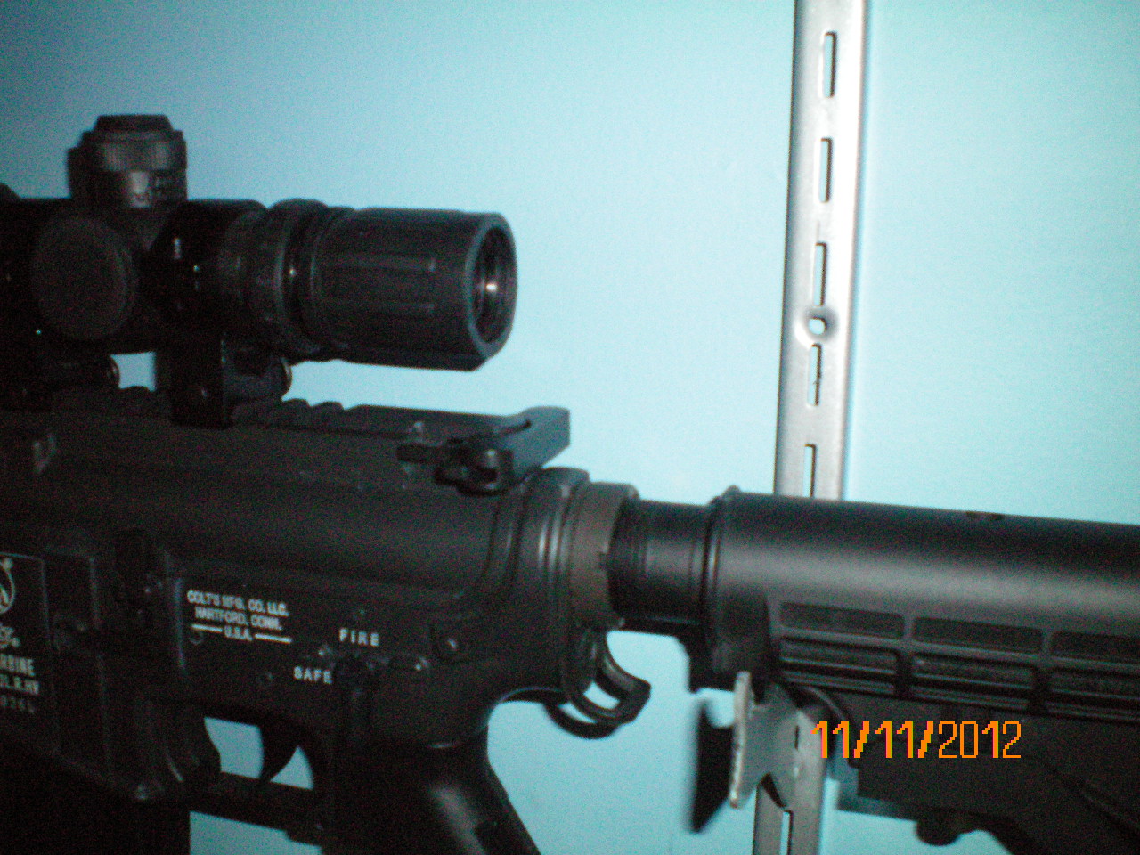

cmscoltm4 Posted November 12, 2012 Report Posted November 12, 2012 Hay guys what is everyone using for a single point sling plate ? What will fit the colt m4 .22?

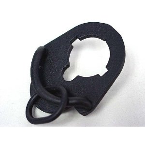

dan01 Posted November 12, 2012 Report Posted November 12, 2012 This generic AR 15/16 receiver end plate fit right on my Walther Colt C 4 22 cal.......Took 15 minutes to install it.......Fit tight too and my NcStar bungee thumb clip single point sling just snaps right on.

techmike Posted November 13, 2012 Report Posted November 13, 2012 Well, I am confused. My Colt M4's OD is 1.129" (28.7mm) measured across the threaded part of the tube.My AR's OD is: 1.162" (29.5mm) measured across the threaded part of the tube.I have several AR sling plates and they all measure ID = 1.18" (30mm)The sling plates that I have are too big for my Colt, they won't stay locked to the notch in the tube. :confused:Glad to hear you found one that works Dan - do you remember where you got it?
Jonny99 Posted November 13, 2012 Report Posted November 13, 2012 This Magpul ASAP fits perfectly on my m4 ops. Be sure to get the AEG version.
wobblinwheel Posted November 13, 2012 Report Posted November 13, 2012 I made one of the oversized ones work on mine by installing it over the existing plate. Just slid it up in the notch, and snugged the nut. Works fine. I have found it to be a more convenient sling location, single or two point use.
