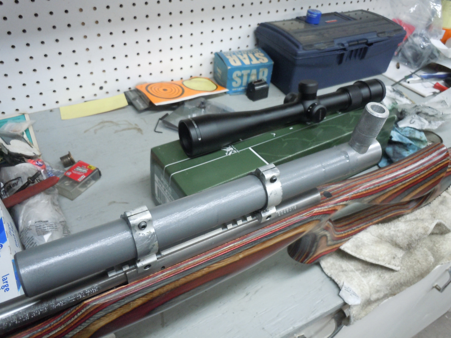

eeyore Posted June 28, 2014 Author Report Share Posted June 28, 2014 I had never lapped a set of scope rings before, but can completely understand the reasons why.Made myself a 1 inch lapping tool. Lapped in the rings, leveled the action, leveled the scope, decided on some baseline torque settings and put it all back together! Quote Link to comment Share on other sites More sharing options...

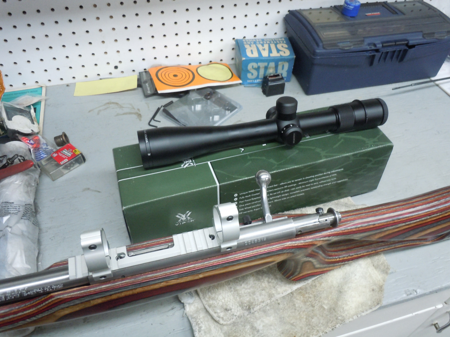

eeyore Posted September 12, 2014 Author Report Share Posted September 12, 2014 Went with a set Leupold Rifleman Rings, wanted a set of rings that hopefully self center and also wanted a silver set! Would not be surprised if I end up with something windage adjustable down the road Quote Link to comment Share on other sites More sharing options...

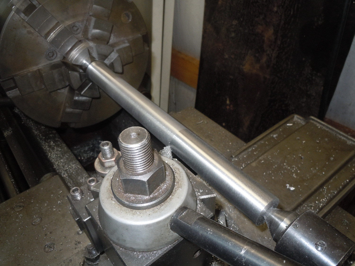

eeyore Posted September 12, 2014 Author Report Share Posted September 12, 2014 The Vortex Scope is a 30mm tube, so I machined up a new 30mm lapping tool, lapped in the rings and debured the edges!Will be putting it through its paces in the next few days! Quote Link to comment Share on other sites More sharing options...
Microgunner Posted September 12, 2014 Report Share Posted September 12, 2014 That's the right way to set up a set of rings.Looks good, although I think black rings on a black scope look better.But that's completely superfluous. Quote Link to comment Share on other sites More sharing options...
eeyore Posted September 12, 2014 Author Report Share Posted September 12, 2014 I am having a little fun with the two tone, with it being a stainless rifle.....but watch for Ruger pics shortly! Quote Link to comment Share on other sites More sharing options...
