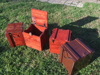

I bought some wood ammo cases from Sportsman's Guide (.com).  These are sold as 'new; never issued.'  I personally suspect the GSA never accepted/bought them;  rejected them.  There is space between some of the boards of 1/16 to 1/8 inch or possibly more.  Lids do not fit quite exactly right on some.  Otherwise,  they are built to Mil Spec and are very strong.  For some purposes the slight ventilation can be good to help keep contents dry or allow volatile gasses to escape.
Each box has a Mil Spec latch and one hinge.  I kept the latches in place;  they are adequate for my needs.  One hinge does not do well;  two are necessary.  I took the hinges off and then cut notches to put two on each of two boxes by notching the box with a small saw and a wood chisel in the same manner as the OEM installation.  I put the hinges at the outer ends of the lid rather than inboard of the top ribs.  I just did.  It works very well.  The OEM screws have a square drive.  I was lucky to have picked up a little set of power drive bits recently that had several sizes of square drive tips along with an assortment of other kinds of driver tips.  Just a little pack of a handful of the drive bits,  brand name is Pittsburg which would indicate I bought them at Harbor Freight;  although I seem to have a memory of picking them off a rack while wandering through the hardware aisle at Target?  On a whim.  I reused the OEM screws for these original offset hinges.
For the other boxes I used 4 inch strap hinges from Harbor Freight. The price at Harbor Freight was half the price at the Big Box stores.  I used #8 sheet metal screws to attach the strap hinges.  A clearance hole is needed for the screw shaft cores but the constant diameter sheet metal screw is much stronger.  I used a drill bit that was barely too small. I put my strap hinges on the backs of the boxes and under the lids at the ribs on on the lids.  I didn't bother to notch the boxes for the strap hinges. The 1/16 lift is not noticeable and with the other problems in the construction of these boxes it is irrelevant.  I put a little Gorilla Glue on the boxes and lids under all the hinges to help hold the hinges in place as an experiment and to lock the screws in place.  A small amount of glue applied with a Q-Tip and a drop of water (catalyst);  oozed and squeezed out for too long.  I wiped and cleaned it for an hour and went to bed and in the morning there was much more white glue ooze that was already too stiff to deal with.  Whatever.  One screw-head on each strap hinge hits the edge of the top of its box.  I did some quick inletting to create clearance using a box knife and then colored the notch and varnished it with a Q-tip for a brush.
I also bought rollers and swivel castors rated at 75 pounds each at Harbor Freight;  much cheaper than anywhere else.  Total load capability of 300 pounds should be much more than I will ever need.  I wiped and lubed my rollers and castors with my gun oil (Mobil One Full Synthetic with 5% Kroil) to make them permanently moisture/corrosion proof.  I put wheels under three boxes and left the other two be.  I intend to double-stack those on the ones with rollers.

In the first post the colors of the boxes in the picture of the group of boxes are:  full "American Walnut" on the right;  the others are "Gunstock."  If looked at closely, the dark box on the right and the middle lighter color box seem to sit on top of the grass while the remaining two sit down in the grass.  That is because of the rollers under the first two.  The lid on the box on the left is half-thinned "American Walnut."
Each box was coated with a stain or stain & sealer,  allowed to dry for an hour or two or overnight, and then given a heavy coat of Helmsman "Satin" Spar Varnish for all-weather all-conditions use.  I started with Rustoleum "American Walnut" stain;  think it is too dark.  Tried thinning it against Rustoleum's advisory.  They are right.  It will thin but it has bad effects on the final result if much thinner is added.  I switched to Minwax "Gunstock" stain & sealer.  Lighter color is better.

The box with the Mil Spec hinges has the last lid.  Minwax stain on the box;  the last lid popped up from being shunted aside along the way after the Minwax stain was used up and it was getting quite dark.  Mixed some "American Walnut" by half with Mineral Spirits and did the staining.  The color diff is one way to identify different boxes.  ;D
