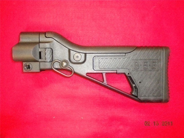

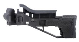

I have the advanced folding stock. I like it so far. It has a 3 position cheek rest, 4 position sliding stock and it also folds to the side. here are a couple of pics i pulled from the web.
