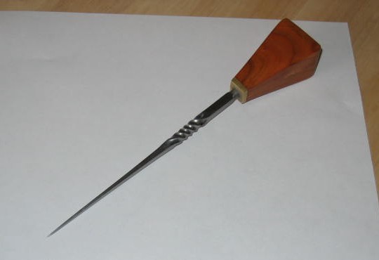

asmurff Posted December 16, 2009 Author Report Share Posted December 16, 2009 On 12/16/2009 at 2:05 AM, imschur said: I made a tool to clean the primer pocketsDo you have a picture, or instructions. After shooting making things is my favorite hobby. Making tools is even better.Nothing to do with guns but I made this recently to replace an el cheapo scribe. Quote Link to comment Share on other sites More sharing options...
