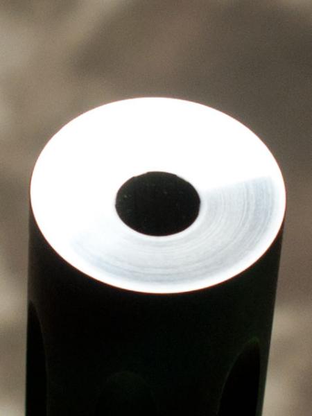

imschur Posted October 20, 2010 Report Share Posted October 20, 2010 Did this horrible deed to my 308 SASS barrel today >:( Quote Link to comment Share on other sites More sharing options...

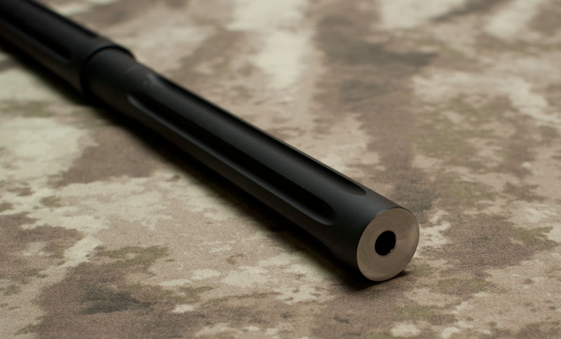

imschur Posted October 20, 2010 Author Report Share Posted October 20, 2010 and another image Quote Link to comment Share on other sites More sharing options...
Madhouse Posted October 21, 2010 Report Share Posted October 21, 2010 Horrible deed? Nah. Quote Link to comment Share on other sites More sharing options...
Microgunner Posted October 21, 2010 Report Share Posted October 21, 2010 What a beautiful crown. You do it yourself? Quote Link to comment Share on other sites More sharing options...
imschur Posted October 21, 2010 Author Report Share Posted October 21, 2010 Yes, I have a decent lathe at my day job.What you cant see is the lathe jaws left some small marks in the teflon despite my best effort. Next time I will try it in a friends shop. He has a lathe setup with collets. The marks aren't even noticeable unless I point them out but irks me none the less.I did get guidance on the proper cutting insert. I hadn't turned stainless before. Quote Link to comment Share on other sites More sharing options...

imschur Posted October 21, 2010 Author Report Share Posted October 21, 2010 Dude, I could have you doing this in 5 minutes. The big deal is making sure the bore is properly indicated and true. Thats why the tools brownells sell all work based on the bore rather than the OD.It's all in the setup. 30 minute setup. 10 Minutes work Quote Link to comment Share on other sites More sharing options...

FS2KSTD Posted October 23, 2010 Report Share Posted October 23, 2010 Alright D ... fill us in. What crown came factory and what crown did you cut to? Post-neutered looks like 11 degree target but it's tough to tell from pics sometimes. "I gots to know?" O0 C:-) Quote Link to comment Share on other sites More sharing options...
imschur Posted October 23, 2010 Author Report Share Posted October 23, 2010 yep, I simply removed the threads for the muzzle device and cut the crown. Quote Link to comment Share on other sites More sharing options...
FS2KSTD Posted October 24, 2010 Report Share Posted October 24, 2010 Gotcha ... liking the exposed target crown better than a muzzle device. :thumb: Quote Link to comment Share on other sites More sharing options...
