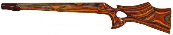

lmao_37 Posted August 12, 2011 Report Share Posted August 12, 2011 I have been buying more goodies for my mosin nagent, first of all the barrel is a little long for hunting purposes so i am going to take off a couple of inches may be down to a 26 inch barrel and iam going thread the barrel with a 14mm x 1 mm pitch thread and fit a muzzel brake, i have choosen the russian AK74 style brake as i like the look of it,i have also ordered a stock from Richards microfit gunstocks its a wildcat thumbhole stock in american walnut,and its going to be a true left hand stock as iam a south paw, i have looked all over the internet for a left hand stock and i finally found someone who does one, its like trying to find rocking horse poop trying find a left hand stock but i had to pay an extra $15 for it Quote Link to comment Share on other sites More sharing options...

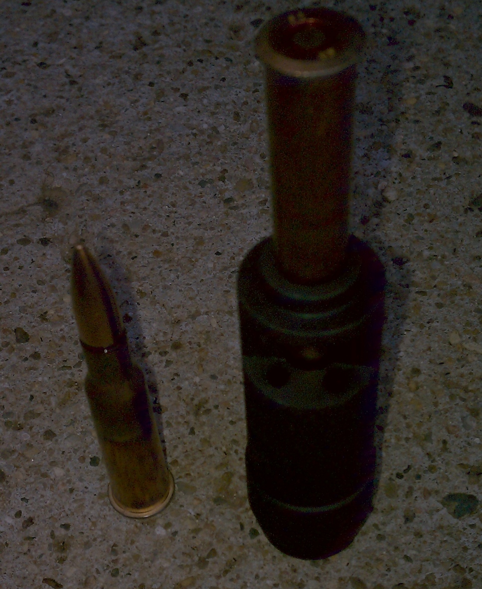

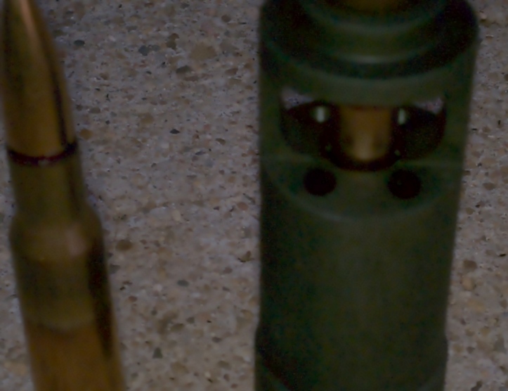

lmao_37 Posted August 19, 2011 Author Report Share Posted August 19, 2011 Ok my muzzle brake has arrived my stock is getting made and will be here in the next 3 months and my dia is somewhere on the south china sea floating this way, i took a couple of photo's of the brake with a 7.62x54 round just to make sure it will work with my mosin. and there is about 3mm each side clearance so it will work nicly with my mosin Quote Link to comment Share on other sites More sharing options...

Microgunner Posted August 19, 2011 Report Share Posted August 19, 2011 The muzzle brake appears to be a fine piece. So far so good. :thumb: Quote Link to comment Share on other sites More sharing options...
techmike Posted August 19, 2011 Report Share Posted August 19, 2011 Nice! FYI, I have a muzzle brake on my .308 that was made for .308, and the exit hole measures 8.76mm. Quote Link to comment Share on other sites More sharing options...

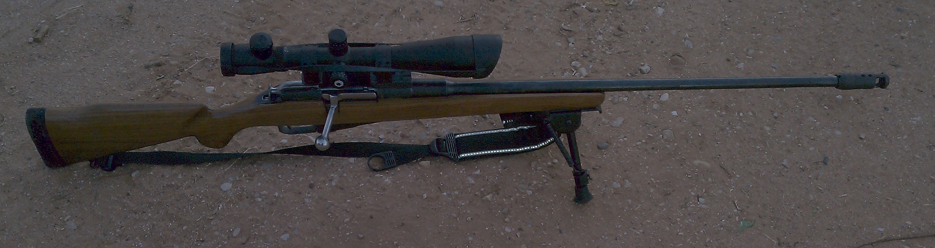

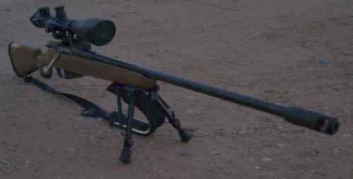

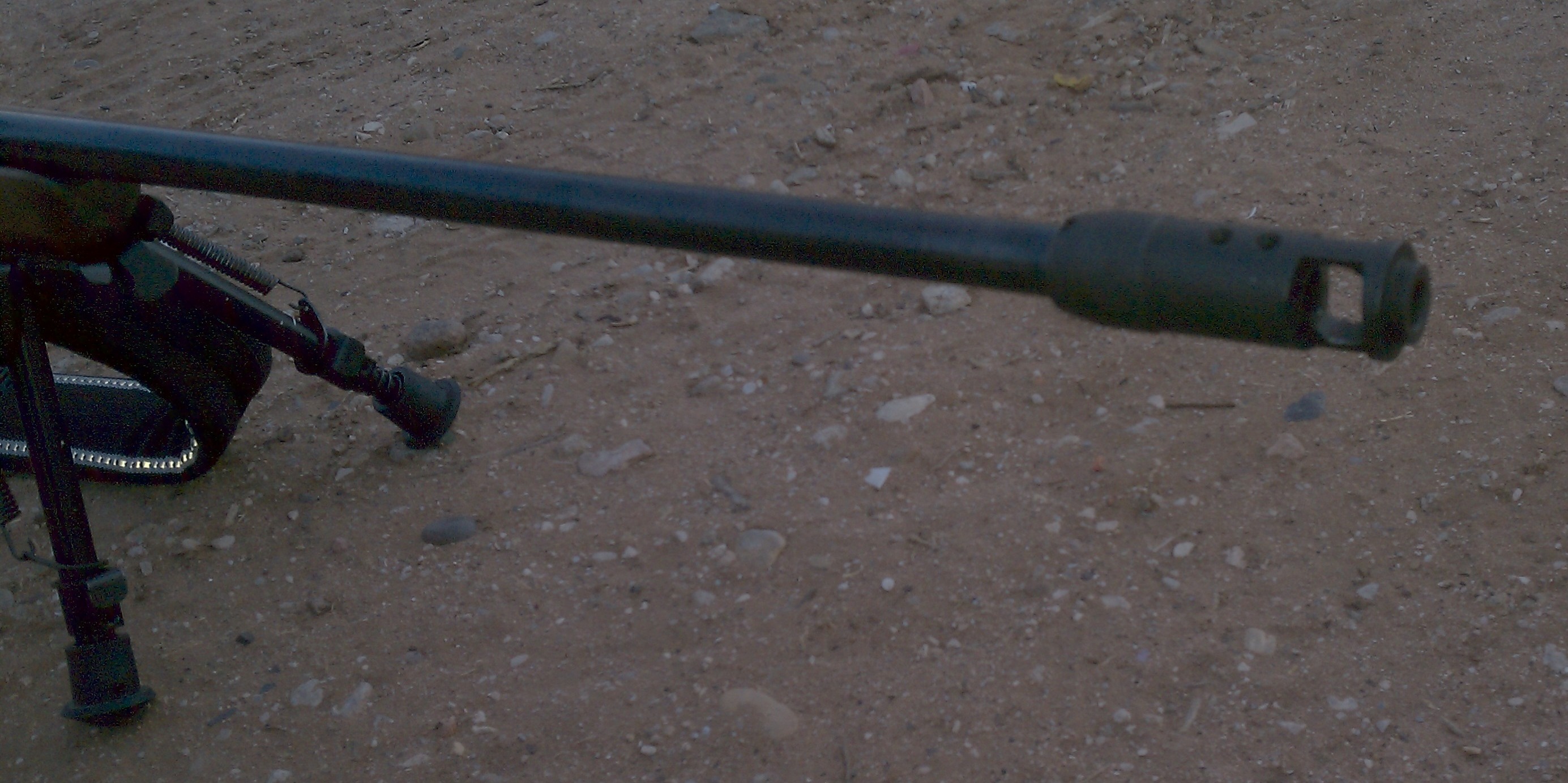

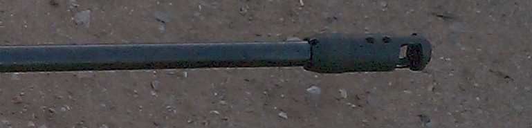

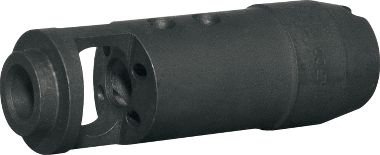

lmao_37 Posted August 19, 2011 Author Report Share Posted August 19, 2011 Well the 14mm x1mm lefthand die turned up today so i went and spoke to a very friendly guy at frontier valley, they do irrigaters for the farmers round here and they have a lathe in there workshop so i asked him if i could borrow his lathe and they said yes, so i cut 3 inches off my rifle barrel and turned down the barrel so i could thread the last inch and here are the results, well iam sorry about the quality of the photos they were taken on my phone also one thing i discovered once i had got the rifle mounted in the lathe chuck is that the bore of the barrel is not in the center of the barrel its off center by about 3 mm which i had to make the dam thing center using the tail stock spinning center, but i have pencil tested the muzzle brake and the pencil is the right dia from the barrel and it does not touch the side of the brake ;D Quote Link to comment Share on other sites More sharing options...
Microgunner Posted August 20, 2011 Report Share Posted August 20, 2011 That looks good, very good. Good thing you cut the barrel down 3". Wow! Quote Link to comment Share on other sites More sharing options...
rodent.22 Posted August 20, 2011 Report Share Posted August 20, 2011 looks GREAT!!! Quote Link to comment Share on other sites More sharing options...
asmurff Posted August 20, 2011 Report Share Posted August 20, 2011 Nice Quote Link to comment Share on other sites More sharing options...
techmike Posted August 20, 2011 Report Share Posted August 20, 2011 Very nice!! Quote Link to comment Share on other sites More sharing options...
imschur Posted August 20, 2011 Report Share Posted August 20, 2011 Really nice, I like that pry bar sized bolt Quote Link to comment Share on other sites More sharing options...
lmao_37 Posted August 20, 2011 Author Report Share Posted August 20, 2011 On 8/20/2011 at 2:28 PM, imschur said: Really nice, I like that pry bar sized boltThank you guys, i love the bolt hand to, pity you don't live closer as i would let you destroy some targets with it and you would see for yourself how good the bolt handle is ;D if you ever come down this way give me a shout. Quote Link to comment Share on other sites More sharing options...
