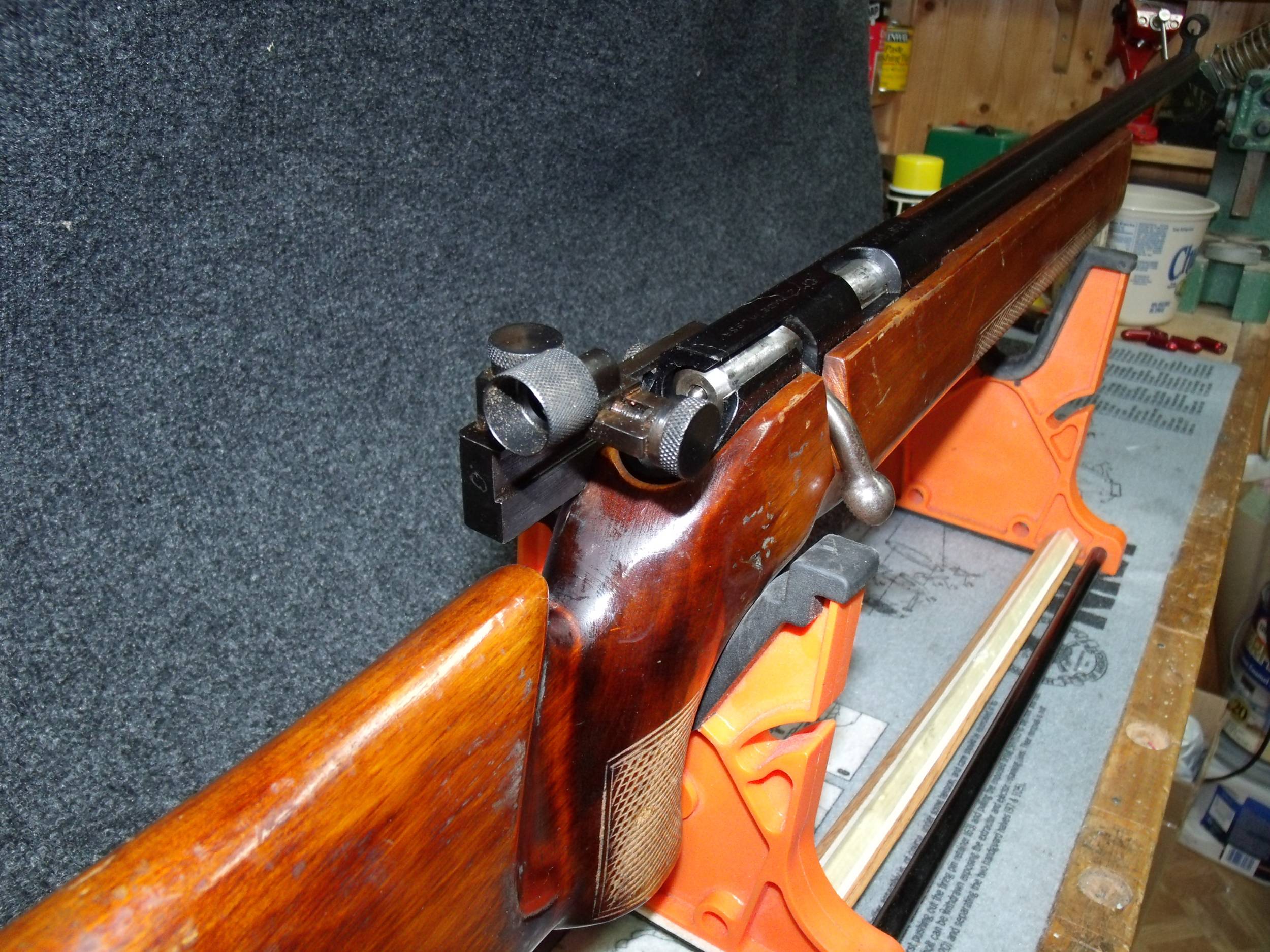

techmike Posted September 3, 2011 Author Report Posted September 3, 2011 Nice, MG! Just received mine, the wood is intact, but will need to be refinished, all the metal is in great shape, trigger pull is set to about 1lb. Will post some pics later today. That rifle was designed for biathlon shooting. Its an older design, the new biathlon rifles have pretty much done away with heavy wood stocks, and gone to lightweight aluminum frame stocks. And they've switched from bolt-action to straight pull fortner actions.No doubt it will be a tack-driver. I'd expect to see it capable of shooting same hole groups to 25m with no problems.You are correct, this is one heavy sucker!

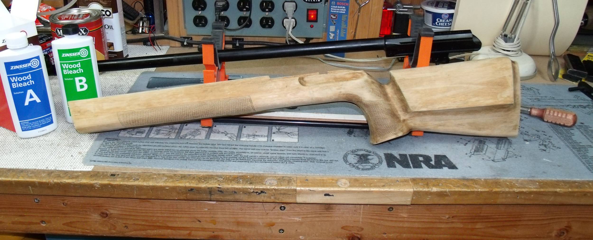

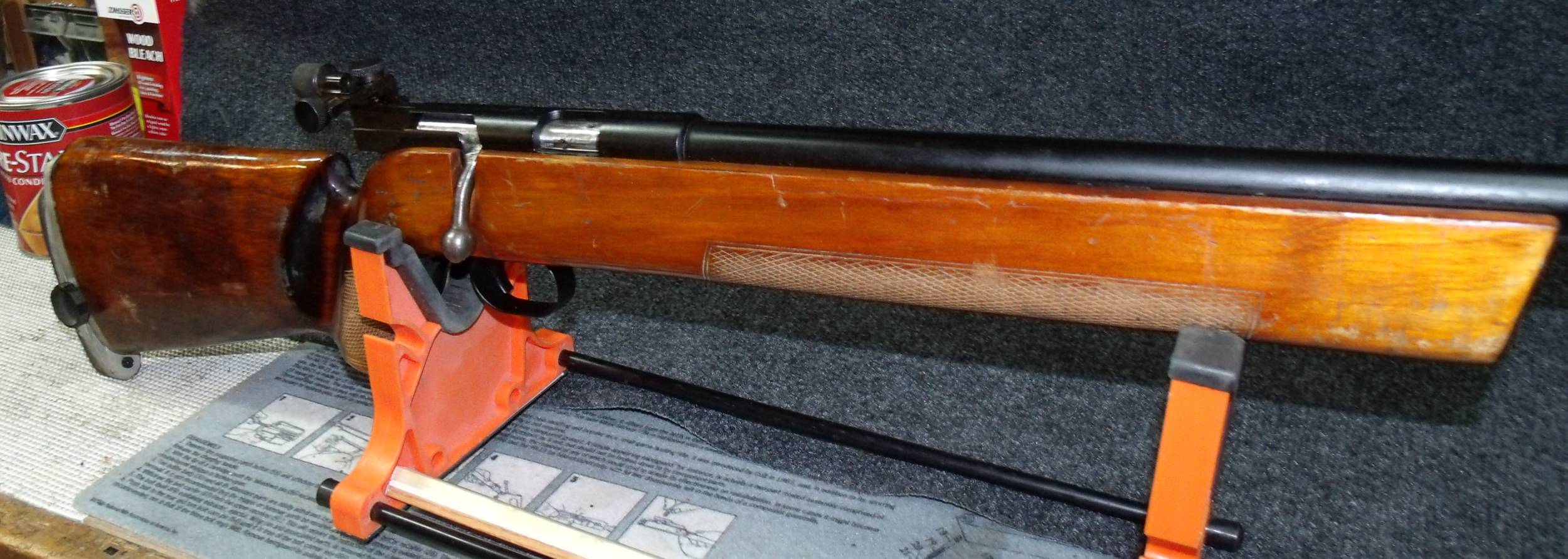

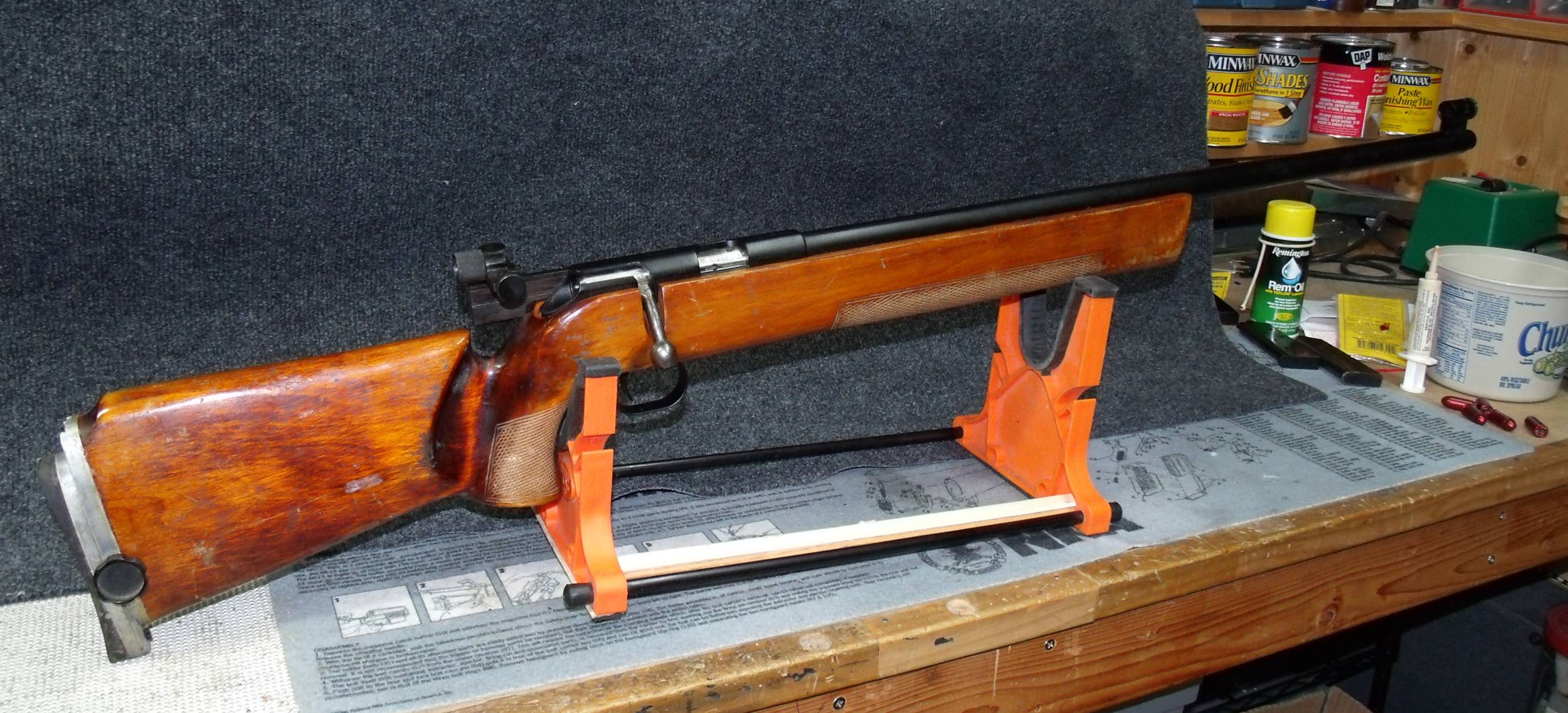

techmike Posted September 10, 2011 Author Report Posted September 10, 2011 The link for the used ones - http://site.cdnninvestments.com/CDNN2011-3/index.html - it is on page 65 - type 65 into the box at the bottom. You will have to call in to order. Mine arrived in good shape, all the numbers match, but, it does not have a walnut stock as advertised-it is some type of birch. I am in process of refinishing mine. Finish removed, bleaching it tonight, pre-stain conditioner tomorrow, then some Watco danish oil finish. All the metal parts except the barrel have been marinating in the ultrasonic cleaner. No work needed there except oiling after rinsing. The sight is in good working order, looking forward to some serious range time with this. :thumb:

techmike Posted September 10, 2011 Author Report Posted September 10, 2011 Thanks MG. Having issues with the bleaching process. Last time I used wood bleach, it was just oxalic acid crystals that you mixed with water. Can't find it anywhere. Had to try some 2 part liquid product that is not as effective. There seems to be many products that are not available anymore.
imschur Posted September 10, 2011 Report Posted September 10, 2011 Two part bleaches should be the best if they are the correct mixture of Sodium Hydroxide and Hydrogen Peroxide. I think the caustic nature of that combo makes them less readily available. Whats the ingredients in your two part? Let me hit google
imschur Posted September 10, 2011 Report Posted September 10, 2011 Jeez all those producs seem to be gone. Kleenstrip wood bleach was supposed to work well but Im not sure if thats still available. As a last resort visit a Marine store. Boat maintenance seems to allow the use of chemicals not allowed elsewhere
imschur Posted September 10, 2011 Report Posted September 10, 2011 also you might be able to find the ingredients seprately and mix your own. I probably have a book that has the ratio's
imschur Posted September 10, 2011 Report Posted September 10, 2011 Here's a brief from the author of the book I was refering too. I think we need a new technical section...hmm3360_5b95904a1bc08233c869072361bb934c0276c549.txt
techmike Posted September 10, 2011 Author Report Posted September 10, 2011 Two part bleaches should be the best if they are the correct mixture of Sodium Hydroxide and Hydrogen Peroxide. I think the caustic nature of that combo makes them less readily available. Whats the ingredients in your two part? Let me hit googleThat is what I found at Woodcraft - Sodium Hydroxide and Hydrogen Peroxide - it is OK, but not as effective as the old oxalic crystals - I could mix that in a stronger concentration for spot applications on dark spots.
techmike Posted September 10, 2011 Author Report Posted September 10, 2011 Jeez all those producs seem to be gone. Kleenstrip wood bleach was supposed to work well but Im not sure if thats still available. As a last resort visit a Marine store. Boat maintenance seems to allow the use of chemicals not allowed elsewhereThanks for the info-good stuff on the wood bleach. A tech library? :thumb: :thumb:Yeah, that is what I found. The employees at the box stores don't even know what wood bleach is.
asmurff Posted September 10, 2011 Report Posted September 10, 2011 Rockler carries Oxalic Acid in powder to be mixed.http://www.rockler.com/product.cfm?page=19462&filter=bleach
