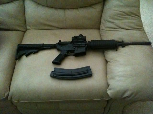

Bagsby Posted August 19, 2010 Report Share Posted August 19, 2010 Hey guys I just picked up my M4 about a weeke ago. I haven't been able to shoot yet due to work which sucks. The feel of it is pretty decent. A buddy of mine has a double star ar15 and the looks are about the same. I just wish the stock and forend didn't have the amount of wobble they do. The only mod so far is a BSG red dot scope that came with the gun. was taken with my phone and in a hurry so will get better pictures soon.I purchased the gun from my local gun shop under consignment from a another customer. I received the original box and some of the manual for it but it didn't have the allen wrenches with it. Does anybody know what the sizes are for the wrenches or if I can order them from umarex? I didn't see anything about them on the website and haven't gotten a response from my email to them yet either. Quote Link to comment Share on other sites More sharing options...

Bagsby Posted August 19, 2010 Author Report Share Posted August 19, 2010 Thanks I am going to be ordering a few new parts for it soon.Looking at going with:CTR stockMOE handguardchanging out the scope to something a little betterbipodsingle point sling w/ black hawk adapter Quote Link to comment Share on other sites More sharing options...

techmike Posted August 20, 2010 Report Share Posted August 20, 2010 Welcome! I think the wrenches are 2.5mm and a long 4.0mm. The stock wobble can be cured by shimming inside the stock with self adhesive teflon tape. But there should not be any wobble or play in the hand-guard. Since you mentioned it was "pre-owned", I would suggest to have it checked before you fire it.TM Quote Link to comment Share on other sites More sharing options...
Bagsby Posted August 20, 2010 Author Report Share Posted August 20, 2010 The handguard isn't too bad it just turns like a fraction of an inch nothing serious. I just was hopeing it was a little tighter but it's nothing I can't fix. Thanks for the tip on the stock. I was checking out Rodent's sloppiness fix thread and was going to do that until I get the ctr stock ordered for a quick fix but might try the Teflon tape instead got tons of that laying around the work to use. Quote Link to comment Share on other sites More sharing options...
techmike Posted August 20, 2010 Report Share Posted August 20, 2010 OK - tighten the set screws on the bottom of the handguard - that should take care of it.TM Quote Link to comment Share on other sites More sharing options...
