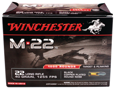

M4rk Posted August 8, 2011 Report Share Posted August 8, 2011 http://picturearchive.auctionarms.com/238455/10229948/acf8a65.jpgi was iffy bout wincherster, but i wanted to give these a try. alsoand this one caught my eyes.http://www.ableammo.com/catalog/images/ssi-2011/74371.jpg Quote Link to comment Share on other sites More sharing options...
